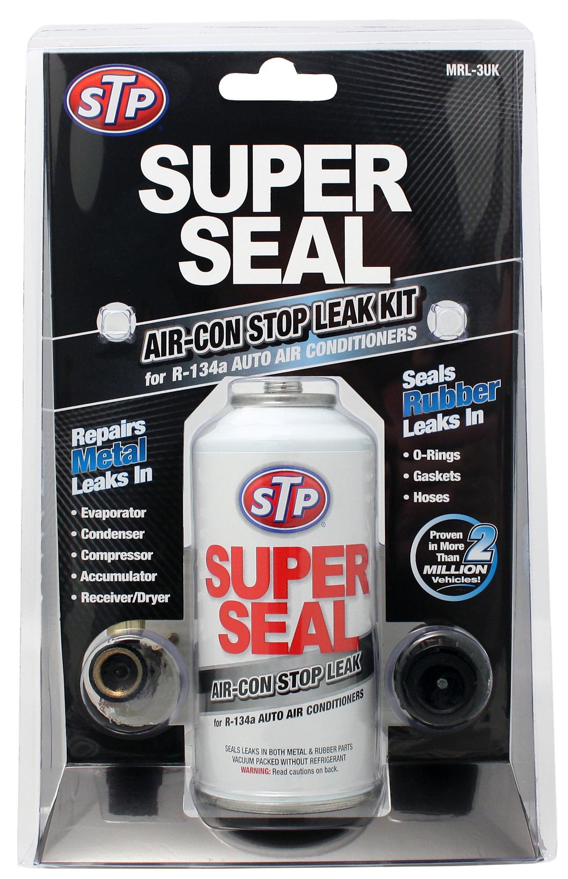

Proven to stop the aircon working and fixing it completely by changing the whole system now, as even what was OK before is now scrap ...warpc0il wrote: ↑Sat Nov 27, 2021 10:21 pmMy guess would be
https://www.halfords.com/motoring/engin ... 34448.html
Im wondering how there was no class law suit against STP for all the damages this product did .... as I didn't hear one good word about it .....
