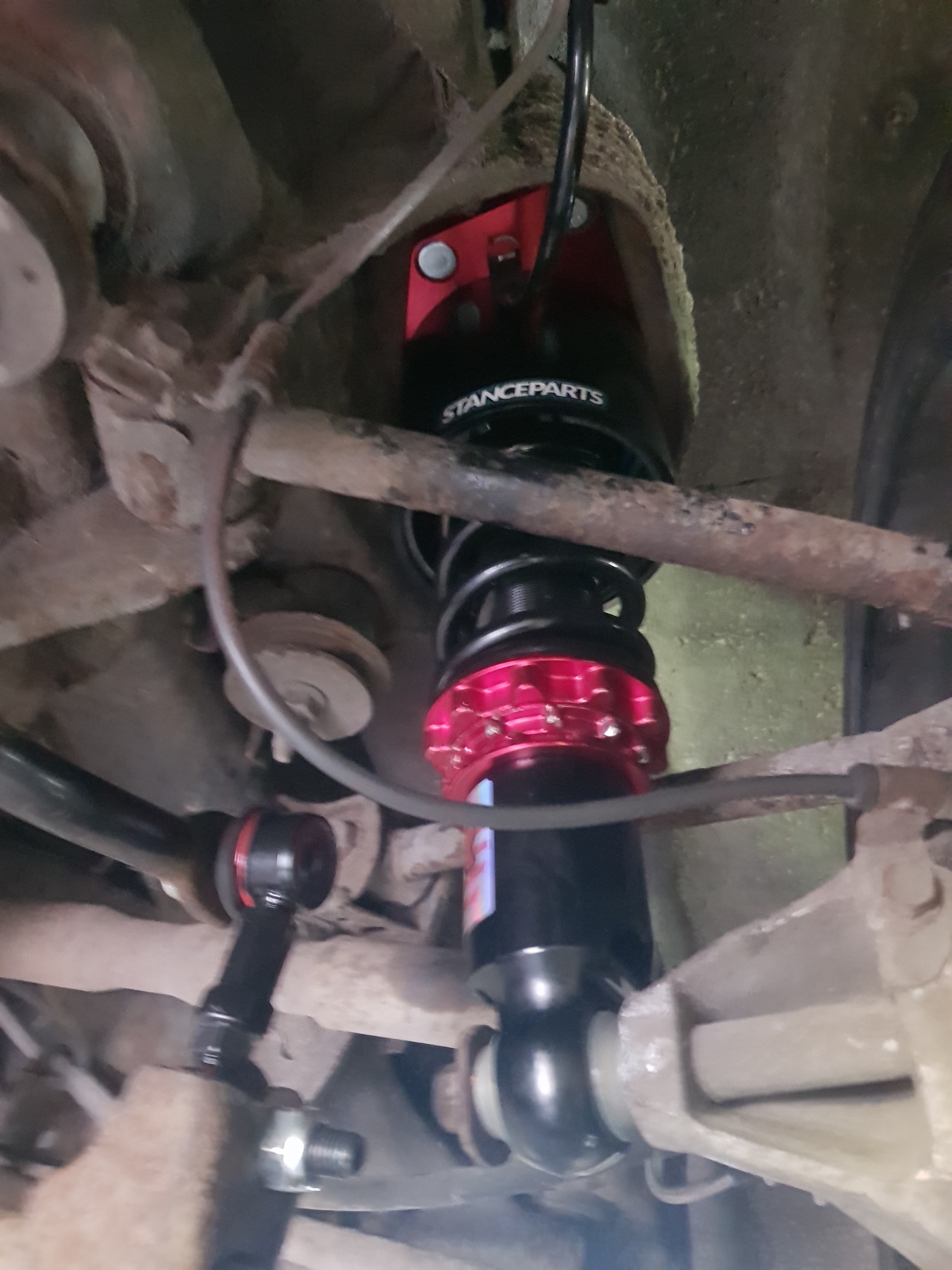

So, after some decisions I decided to go Aircups + MeisterR coilovers combination, and found only one company not far away from me that can handle this installation, because they are official HSD distributors here and do know something about adjustable suspensions, everything went smooth with installation during few days except for today... when they tried to put the car on the floor, fronts where exactly how I wanted and on full soft dumping adjustment they were bouncing when you "bounce" the car from the front, but situation with rear went much worse... dumping been set to max soft as well, but when the wheels touches floor the wheel stays at the same hight, even when 2 guys sat into trunk the car height haven't been moving at all, they tried to unscrew anti roll bars just to be sure that not the case, but that haven't done any change, I did sent email to MeisterR's to see what they think, but might be that isn't the fault of spring (which is only 5kg vs 8kg of fronts) but something that been overtightened by workers?
Here are some photos of what I'm talking about:

So,does the rear ride height not drop even when the spring seats are wound right down :?:

Did they retighten the suspension pivot bolts with the weight off the wheels?
This can result in the bushes acting as rubber torsion holding the car up.
Pivot bolts shouldn't be tighten until the suspension is at the normal ride height.

Re: Meister R coilovers
Post by tayfun » Fri Aug 10, 2018 8:38 pm
SeeJay wrote:
Fri Aug 10, 2018 7:23 pm
Exactly :c
tayfun
Posts: 316
Joined: Sun Sep 25, 2011 11:49 am
Post by tayfun » Fri Aug 10, 2018 8:43 pm
warpc0il wrote:
Fri Aug 10, 2018 7:53 pm
Sent from my SM-G800F using Tapatalk
I did have chat with them just few hours ago about not tightening anything before lowering the car/wheels, and they said they did tighten everything because otherwise the bolts would damage the rubber bushes, but on Monday they'll try to keep un-tighten everything and lower the car...
also I had a chat with few guys that had installed air suspension on their cars and they said that on the rears there was issue to put regular bags, because the shaft bumps into the dumper (whatever that means) and that's why the the height doesn't goes anywhere down, maybe that might be a reason...
Post by SeeJay » Fri Aug 10, 2018 9:08 pm
As far as I know,air cups are only installed on the front,to enable raising & lowering of the ride height to clear speed humps,etc.
Have they somehow linked it to the rear :?: :shock:

I probably now understood what air-guys been talking about... if we'll imagine that this coilovers got similar structure as our stock suspension, and on this diagram we'll imagine that purple is air cup, then the cup just stops the red part from going inside into stock cup... so there is no way to fit cups on rear... or am I wrong?

You don't have the part 11 on the Meisters. If the air guys said there were issues with the rears why proceed and try to fit them.
The guys fitting these parts don't seem to understand how to bolt suspension together. Also on the rear I don't think you need to undo anything except the shock absorber bolts to change the units.

Thanks for your replies guys, the issue is with the structure of our rear suspension, the dumper just hitting the air cup, when it's required to go further inside the top mount, so I'll need to deal with the air cup guys now, as they were promising me that it will fit when I was asking them several times, and also saying that they have customers that fitted them on rear before, and when I contacted that guy they posted on their page, he said he installed only fronts...
