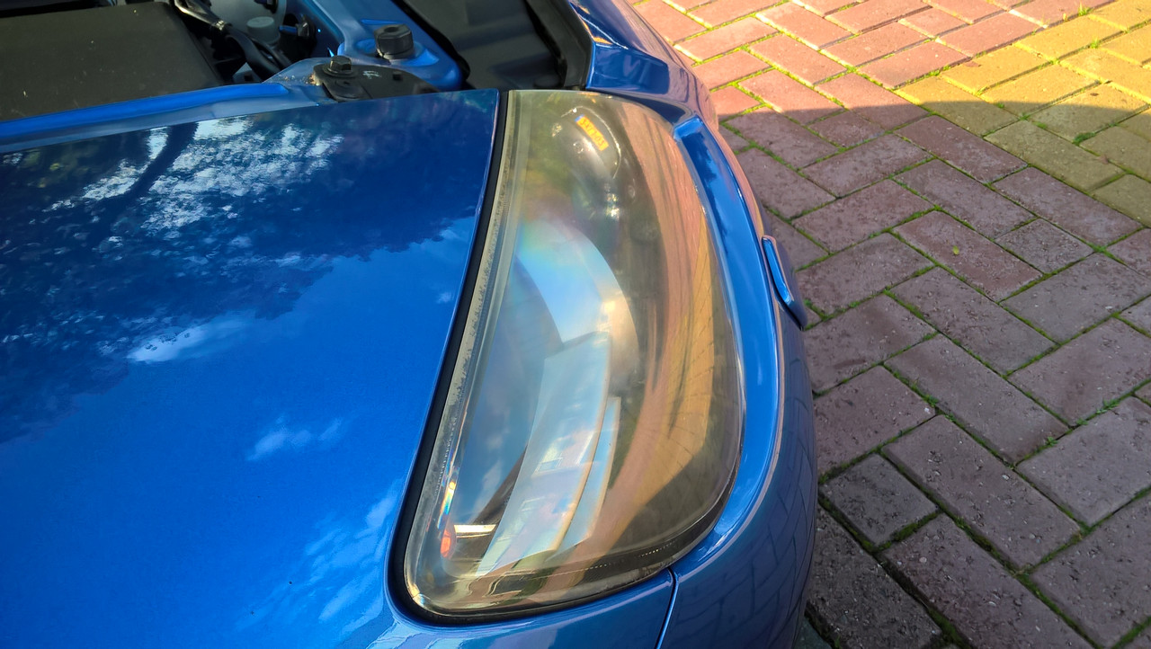

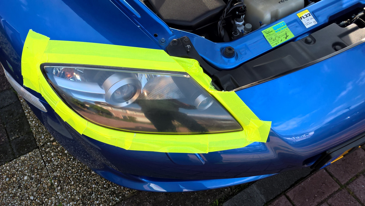

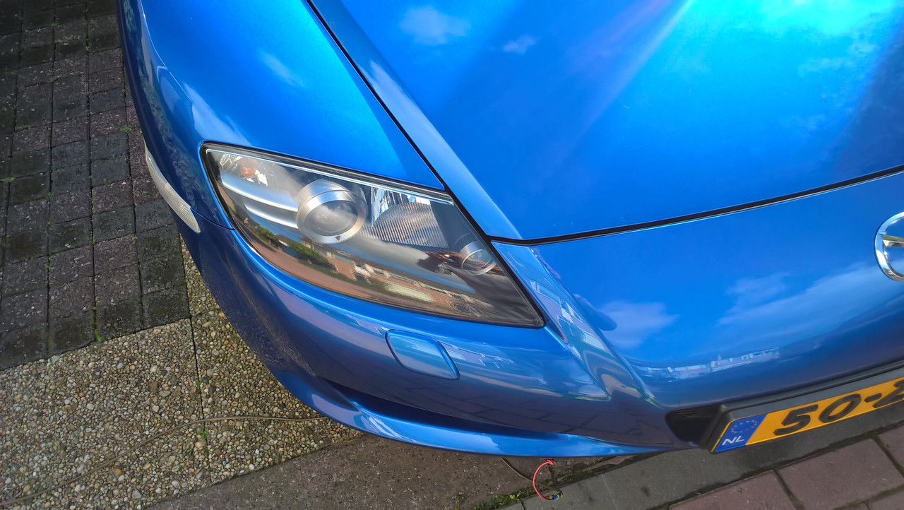

Post by Rudolph » Tue Nov 12, 2019 1:36 am
Refurb of my headlamp plastic covers........of my 2008 45.000 mls RX-8 HP.
- sanding rough to remove the complete hard UV layer
- sanding fine
- polishing rough
- polishing fine
- 3 layers of 2 component clear coating to restore the UV protection
Restoration kit (without spray can) for € 12,35 free home.........plus (locally purchased) one spray can 2 component clear lacquer

Post by Rudolph » Tue Nov 12, 2019 5:28 pm
johnbb99 wrote:
Tue Nov 12, 2019 12:14 pm
I've been wondering what to re-coat mine with after refurbishment.
Some products are really expensive and I wonder which ones are are worth getting?
Any 2K clear lacquer will work fine.
2K is better as 1K since it is more resistant against uv radiation, moisture, grease, fuel, road salt etc.
The immediate application after restoring the brightness of the lamps is important because this 2K lacquer will keep the lamps clear for 5-15 years(dependent upon number of layers), whereas without this protective layer the oxidation of the uncovered plastic material will start immediately after the polishing treatment.....within a couple of months the first signs are visible.
As an example I used the next 2K lacquer where both components are stored in the spraycan and are mixed just before starting spraying by an ingenious system.
https://www.amazon.co.uk/clear-lacquer- ... B00CLAGWAY
https://www.vernicispray.co.uk/23404224 ... -gloss.jsp
