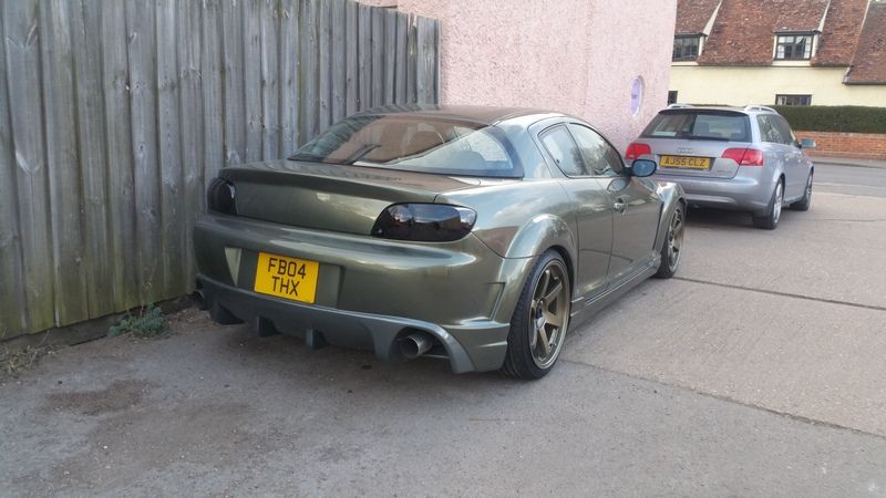

I did drill one of them years ago, guess which one suffers with condensation now
This is only after a damp night and it very quickly evaporates, but led me to work out what was going on.
