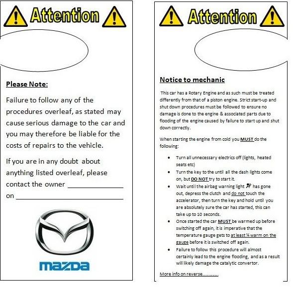

RX8 Service Notice To Be Used Whilst Car Is Undergoing Work
Right, in light of my recent trip to Mazda for body work, and the possibility of them flooding my car, and trying to cover up and lie about it!!
I have created a little Service notice which i am now going to stick on the steering wheel everytime the Rex goes anywhere for work or service!
I have decided that all of us could do with one of these notices, to protect our cars from tw$ts!
I have put the image on my Photobucket, for all to download and use.
I have printed it onto glossy photo paper and laminated it, the image is a 10x8 so it fits nicely in the glove box!
Maybe this notice cold be put somewhere for everybody to access it? Hints and tips maybe?
If everybody downloads and uses these at various places, maybe we can start to educate those who dont know our cars and engines! and save us the hassle of non self inflicted repairs and damage!!
Mods put where you like!
I can also alter the image if peeps have any ideas to what the text reads!

Excellent..problem is whether these guys at the stealers can actually read
...perhaps some pictures of Pat Butcher may help...remember these guys are morons ](./images/smilies/eusa_wall.gif)

HaHa!! Temperature!!
Its late dude!!, and ill add the no throttle.
and they could read the bit in Mazda handbook where it says "Shaft every Rex owner, that passes through the door" lol
Edited Original Link And Added Text

cheers mate nice work i,ve copied this
and will use it when she goes in for owt doin,
i did some thin similar but yours looks like its been done by mazda

In light of your recent experiences, it might be appropriate to add reminders to reset DSC if the battery has been disconnected.
Great idea BTW and I will be using this myself.

I think the "no throttle" bit is unnecessary because its an electronic throttle. So if you push it when the engine is off, it won't inject any fuel... at least thats the way I think it is.

Its a specific instruction not to apply any throttle during the starting procdure.
Nice one Vinnie.

Yes if you apply the throttle whislt starting it will inject extra fuel into the cold engine, and if the car doesnt start first time, it greatly increases the risk of flooding

I did a bit of research and found out that pressing the accelerator pedal whilst turning the key indicates to the ECU you are preforming the de-flooding procedure, and it does not supply fuel to the engine while cranking. So you won't increase a chance of flooding doin this... but obviously you still dont want to be touching the accelerator when starting the car unless you are actually trying to deflood your engine. So I think I am right and wrong at the same time!VelocityVinnie wrote:Yes if you apply the throttle whislt starting it will inject extra fuel into the cold engine, and if the car doesnt start first time, it greatly increases the risk of flooding

Your right and wrong, the ECU will only think this if the throttle is fully open (foot to floor), if you start with partial throttle like on a normal engine it will inject more fuel.
Hense why you should not crank the engine with any throttle at all.
