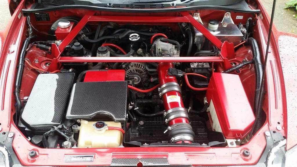

I've noticed quite high intake temps, up to 150F in traffic which seems silly at below 5C ambient temperature.
I have the K&N intake:
*Random Pic
It makes sense that the temps are high since it get most of the air from under the hood at low speed, so I've been contemplating to try and force the air through the hole from the stock box. I know the intake/MAF is quite sensitive and the wrong setup could make things potentialy worse.
I found the below example of custom mods people have done:
Would a combination of these, aka running a hose directly to the K&N be a bad idea?

The K&N Typhoon is the definition of a bad idea.

K&N Typhoons have a rubbish reputation.. and a definite downgrade to the Mazda setup, which was really well done.. take the darn thing off.. causes real problems as you have now experienced, what on earth possessed you to buy that.. loads of anti info around :(

Got it as a real bargin and with a spare MAF. The reason I bought it is the amazing sound it produces. Stock intake sounds boring compared to it IMO.

Yes but it fecks the cars performance big time, in comparison to stock.. a bargain doesn't mean it's any good :(

A lot of 8 owners have complained it affects the car with lumpy revs, cutting out and all round poorer air flow.. I was talked out of fitting one by the specialist I take my car to, and for me that's testament enough ;)
He did say, unless you fit an AEM or Racing Beat.. (and that's only for the noise) it won't improve breathing performance over the stock intake!

Don't know about flow rates ect but intake temps halve with the aem and it's cheap, looks good and available in lots of colours. But I won't sit here saying I gives me X bhp I had It for sound and style

My PZ came with a K&N Typhoon and I was advised by Essex Rotary to get rid of it.
Changing to the stock airbox with a K&N panel filter made a massive difference. We are talking night and day! Smoother idle and better pickup through the rev range
The typhoon does sound epic when the SSV opens tho and I did miss that
