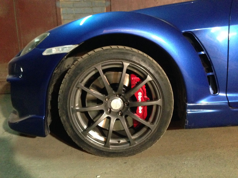

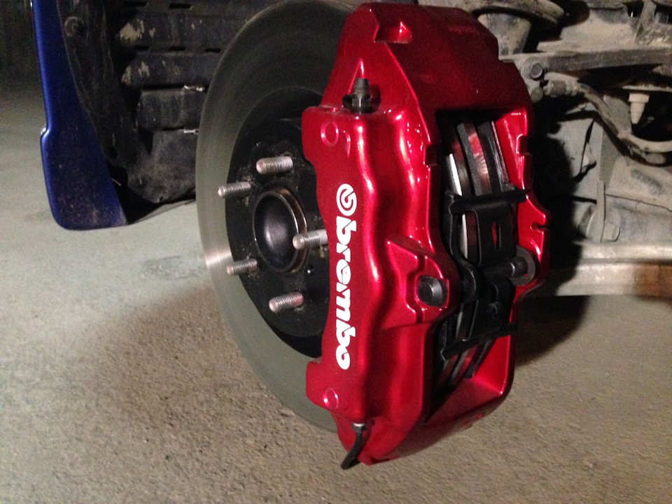

I know that bmw e38 does have front 4pot brembos, I don't know what situation on that in UK, but in Eastern Europe you can get them for £80-100, but they need some non-standart discs, but in total this might be the cheapest BBK solution
But if you have slightly bigger budget - Porsche's/Audio's 6pot looks waaay better on RX8, especially in candy red colour :shock:

I would go the tayfun route, buy some brembo four pots (make sure they are fronts if you are looking at the Porsche ones) and see what lines up where and what's needed for a bracket, then do some measurements on what size discs you need, would prob all be easier to mock up on a old hub.

No dust seals, so they need servicing more often Image
I do actually know the possible answer to this - but need to check some equations. 4 opposed pistons vs 1 single is likely to have an actual greater surface area - so even if the pads are the same size, it's more effective, plus opposed pistons gives a higher chance of better pedal feel and greater modulation (yes yes, I know many other factors at play).
Obviously not anywhere near that simple - but most likely answers - more analysis needed with more specifics for a proper answer ;)
They do look cooler though.
But for a street car, I quite like my dust seals thanks.

A fair question, which I'm not 100% sure about. The fact that there are more pistons and a more even spread of pressure must be beneficial, as well as a presumably higher maximum pressure achievable? That said, the RX8s brakes aren't left wanting.
Beyond this it comes down to a bit of behind-wheel-bling, as they look badass... I have found this especially with the R3 as the calipers look tiny sat behind them - admittedly, this is due to having hoofing great wheels...
