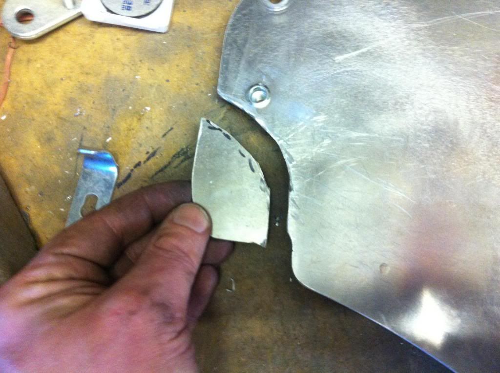

Had a day off yesterday so had a play with getting my kit fitted
Stage 1, get the plate to fit
First job to get the plate fitted. flipping it round is a pretty good fit, there are 2 issues
1. The rivnuts are on the wrong side, easily solved. 10mm drill bit in the pilar drill and they are gone. Now replaced with equivelant rivnuts from my draw, but installed from the other side.
2. The plate itself needs trimming to prevent it from fouling a pipe coming through the firewall. In reality a 10- 15mm trim would have been sufficient. I got a little carried way.
3. the top mounting hole nearest the passenger wing, needs elongating to a slot rather than a hole

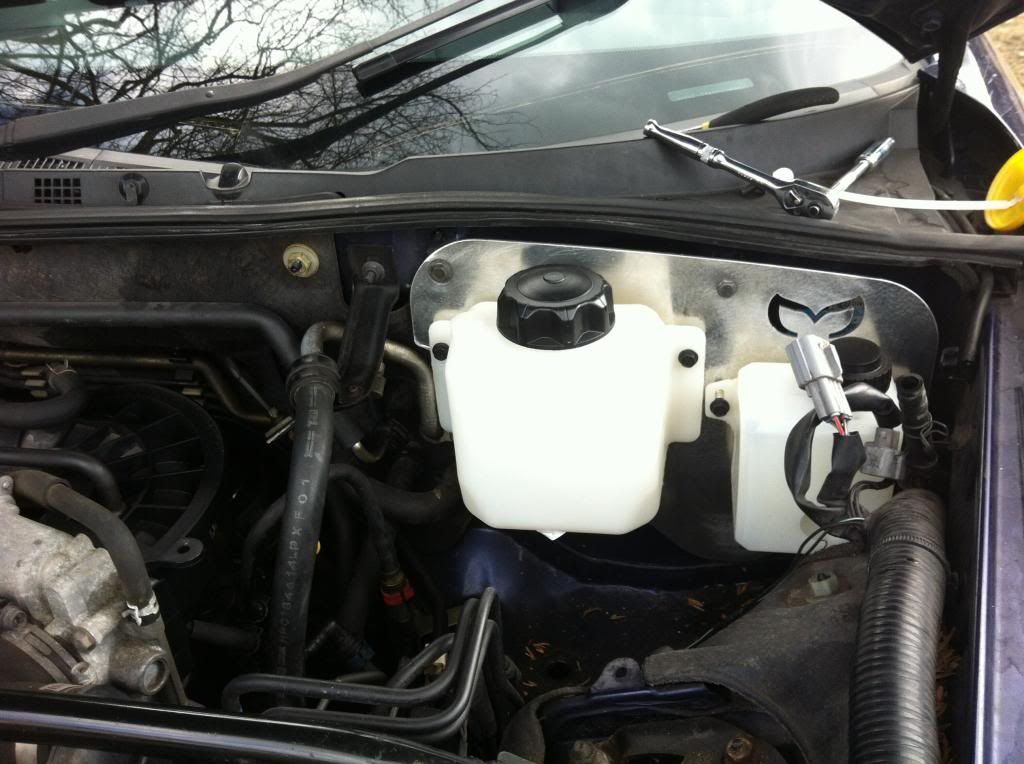

Stage 2, Fit the bottles
no big deal here, all fitted on the plate and in the car with no issues,
I do reckon the bottles would still fit if bigger though, there is room for the small washer bottle to be an inch taller and the 2 stroke bottle to be at least 3 inches taller

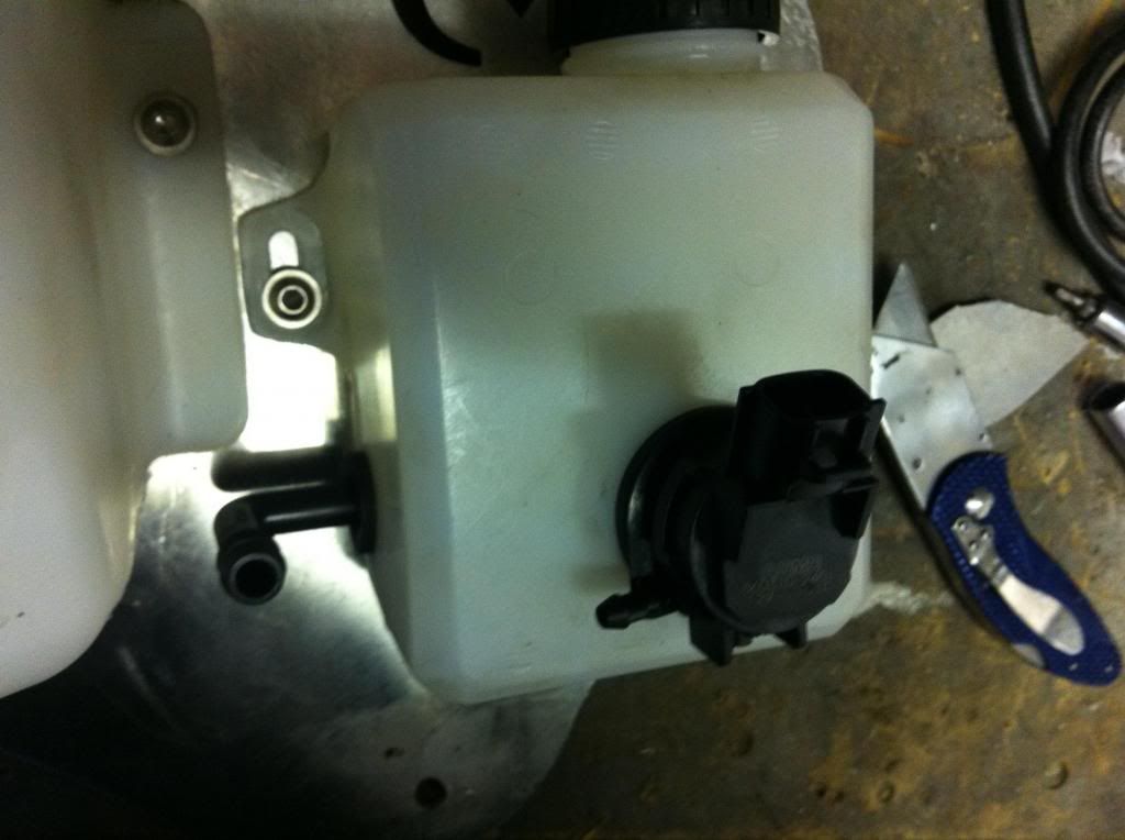

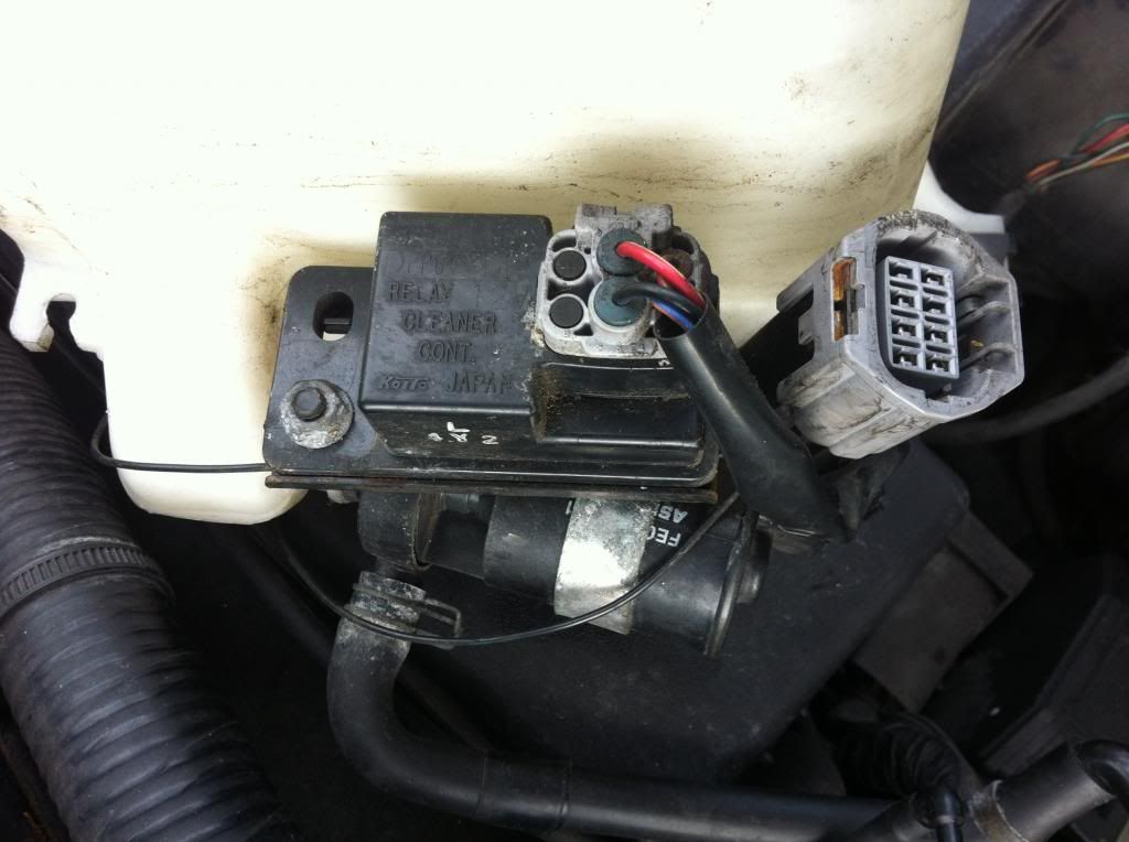

Stage 3 Fitting the hardware to the bottles
This little lot appears to be the relay for the washer level sender and the secondary pump for the headlight washers. There is no provision for this so I guess either the US don't have them at all, or the kit was designed for a 192 which may not have the headlight washers?
I figured I'd worry about the level sensor later, so first the secondary pump.
The stock washer bottle has another hole for the secondary pump, the new one doesn't. To get around this I dismantled the pipe and rubber seal assembly for the secondary pump.
drilled a hole (14mm) in the side of the new bottle, and reused the seal from the pump in this hole. I inserted the plastic elbow from the stock pipe into the seal and its a perfect leak free fit

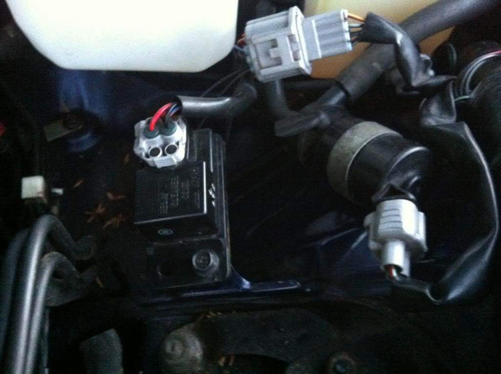

Now With pics of relocated secondary pump and relay
fortunately there is a hole and threaded stud in clo proximity to the bottles, so an easy relocation of the secondary pump and really was not much of an issue
