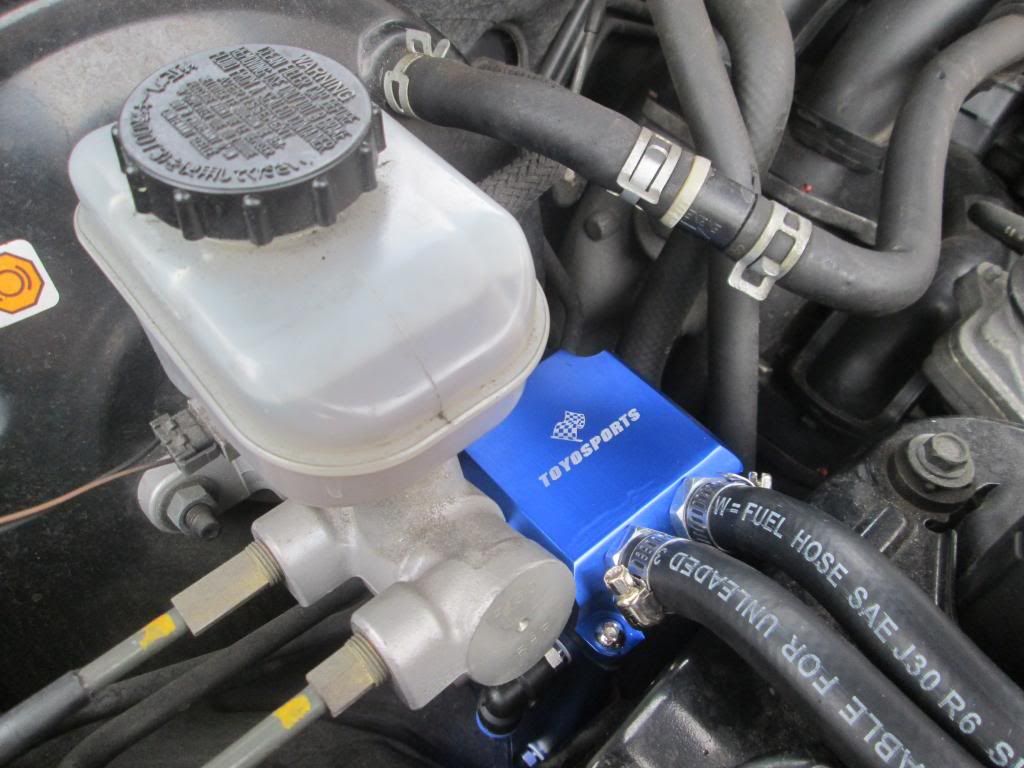

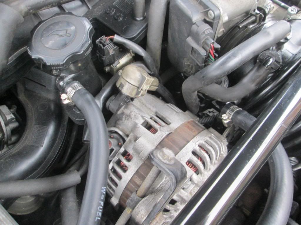

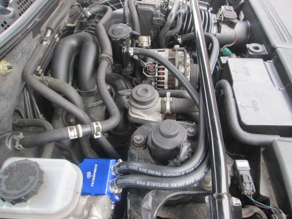

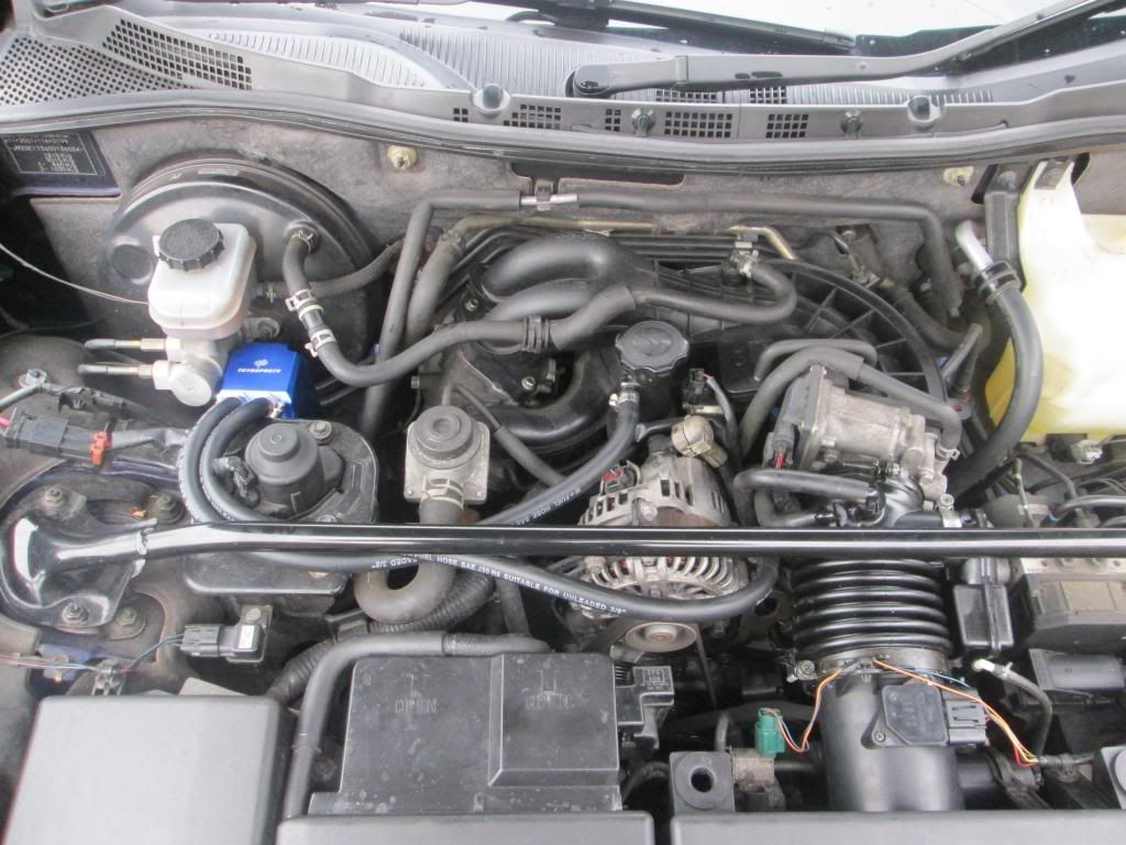

MARKTHOMASBRAND, is the Toyosports oil catch this one: http://www.toyosports.co.uk/oil-catch-t ... 9-22-p.asp? With the 9mm fittings?
I have just bought a 2003 231, I have yet to check my MAF or air filter to see if its junked up, so I'm not sure I will need one yet.
Is it a hassle to empty them out? What is the fitting bracket fixed to? Any 'modification' required to fit it in that gap?
Great photos by the way! Seriously useful. :notworthy:
