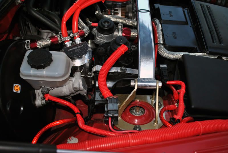

SARD do a specific kit for the RX-8, which appears to be a variation of their universal one with a custom bracket.
Locates the tank on the other side of the brake reservoir:

exiled-viking
Posts: 1411
Joined: Thu Jun 18, 2009 10:28 pm
RX-8: Supercharged
Location: RUGBY
Re: Let's talk oil catch cans
Post by exiled-viking » Wed Oct 26, 2011 10:35 pm
sorry this is a little out of focus but mine only holds 600 mil as i can now down size my catch tank due to fitting the new greddy oil pan ,as this anti surge plates that help the problem also the oil pan is a little larger than the mazda spec so filling the oil to 3/4 mark on the dip stick is the same as filling it to the full mark on the old dip stick with the old oil pan this has now completely stopped the problem i was having :)
http://i373.photobucket.com/albums/oo17 ... 1319488348<--- click on this :wink:
http://i373.photobucket.com/albums/oo17 ... 1319488974
you can just see the top of the can in this photo with the hose mounted with the blue connections as i said its only 600 mil tank.
180 modifications AS AT 21/05/2012/ 22 new mods for this year sorry for spelling and grammar mistakes !, supercharged, full interior trim , paint job,diamond black, metallic orange,HKS CAMP2-2 ecu,s mazda/HKS ECU F,con-IS FUEL management system,,fully bluetooth/ loads of gadgets, fully upgraded brakes,discs, suspension,exhaust,greedy oil pan,TPMS ,
