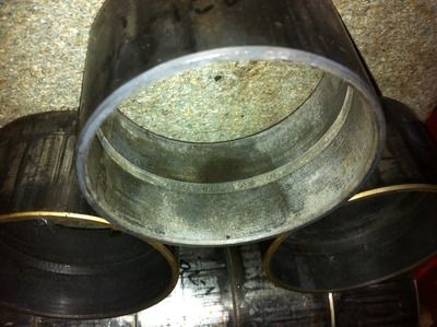

this is a rear stationary gear bearing that is showing wear - its not great but your not to expect anything catastrophic to happen any time soon!
this is another rear stationary gear bearing that is worn right through to the copper ... again its not great but not urgent that you fix it!
this is 1st bearing i showed you's twin (ie front stationary gear bearing) its not great!
this is another rear bearing, you can see with this 1 part of the copper has chipped away. this bearing is on its way out now and could last anything from 1000 - 10000 miles but its days are numbered
this is the last bearings front bearing, its in a similar state - which is rare they don't normally wear the same (in my limited experience)
this bearing has failed completely and is the reason the engine was stripped down! it was a rear stationary gear bearing and the inside edge of it is no long round but egg shaped, also you can just make out the lip on the top edge that folded over ... if this happens your eccentric shaft will go with it :( and its not uncommon!
this is another bearing that as you can see is well and truly knackered! ... BUT it hadn't reared its ugly head and the low compression engine that it was in still ran quite happily :shock: this is also not uncommon!! this bearing didn't have very long left!!! front bearing
this is the above bearings twin (rear bearing) you can see the level of wear is a million miles apart!
another bearing through to the copper
now this bearing was front stationary gear bearing, it was in a club members car and slipped at Blyton this last AGM (some of you will remember) its didn't just slip completely shredding itself on the locating pin it also destroyed the stationary gear, eccentric shaft and half the front cover assembly!!!
you can see in this picture the egg shape of the bearing and the complete lack of anything inside ie no zinc OR copper
and this is some of the horror it caused under the front cover!

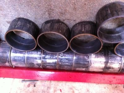

and for the benefit of anyone who might think I'm spinning them a tale here's a few pics of a couple of bearings that are still in there own stationary gear, they were removed from an engine that had done ONLY 56000 miles and was suffering from low compression on both rotors, not bearing failure!!
the front gear is the small 1 on the left and the rear is the larger on the right ive taken pictures of the left and right side of both bearings as you look at them here
left side rear bearing
right side rear bearing
left side front bearing
right side front bearing
these bearings came out of the exact same engine!!!!! they did the same mileage, under the same conditions with the same amount of services etc etc and as you can see the rear bearing is fine but the front well f*****d for lack of a better word!
so the next time you or anyone you know visits a specialist or general garage and is told that your rear stationary gear bearing is on its way out, urgently needs fixing and you can have it done there and then for £400 :shock: then please ask them what it is exactly they plan on doing about the front bearing!!!! there's a 50% chance that (less id say as more often than not the front bearing is in worse nick than the rear) replacing the rear bearing will help your engine keep going ... and 50% chance your wasting your money!!!!

a pic or 2 of rotor bearings
as you can see rotor bearings dont seem to have the same issues as gear bearings thank god!!! ive never seen 1 showing its copper through but i ALWAYS change them anyway (you might have guessed :roll: ) ... just incase! i wouldnt want to have to go to the trouble of stripping and engine a second time for the sake of the bloody rotor bearings :lol:

Post by benedunn » Fri Jun 01, 2012 9:03 pm
hey James has that eccentric shaft cracked :shock:
Please excuse the spelling mistakes ^^ :D
I'll second that!

hadlowj
Posts: 1635
Joined: Fri Apr 09, 2010 3:54 pm
Location: Suffolk
Re: Stationary Gear bearings
Post by hadlowj » Fri Jun 01, 2012 9:07 pm
OO did not notice that, I only took that engine apart a few days ago and have not properly inspected it after seeing the front but in the pic that does look like hair cracks. I will give it a good go over tomorrow and find out.
exiled-viking
Posts: 1411
Joined: Thu Jun 18, 2009 10:28 pm
RX-8: Supercharged
Location: RUGBY
Post by exiled-viking » Fri Jun 01, 2012 9:24 pm
some of us have been saying this for years but it seems to fall on deff ears there was one so called spin doctor on here that nearly ended up in court by dissing/ making a false allegation about the oil how ever i have always used this oil,
even in the gear- box :shock: for the last 29,000 miles and 14,000 in the diff :shock: how ever i am now using a different oil in the diff :!: :!:
mind you i change my oil more than most., every 3000 or 6 months so my car was serviced in march and its only done 360 miles so the next service will not be any where near 1000 but i think your almost hitting the nail on the head by saying the oil is way to thin in its viscosity that mazda needed for this engine :!:
well done lads nice write up =D> =D> =D> nice bright idea with the photos :idea: :idea:

benedunn
Posts: 4640
Joined: Fri Jul 02, 2010 5:18 pm
Location: West Yorks
Has thanked: 5 times
Been thanked: 91 times
Post by benedunn » Fri Jun 01, 2012 9:36 pm
a photo says a thousand words ... i figured we needed to get the point to hit home!!
this thread is not about protecting your stationary gear bearings and which oil to use its litterally about protecting your wallet for people conning you by charging you obsene amounts of money to half fix a problem they know for absolute certanty you have simply because most 8's will be showing least some level of wear on both bearings :wink:
I'll second that!

vic_cambridge
Posts: 1767
Joined: Sun Mar 04, 2012 12:30 pm
Location: Cambridge
Post by vic_cambridge » Fri Jun 01, 2012 10:01 pm
As this topic is just about the stationary gear bearings people searching would prob hit this topic first for the answer to this question.
Are there tell tale signs, noises etc that indicate that they can be on their way out at all. E.G. when a wheel bearings goes you start to know because of the noise.

benedunn
Posts: 4640
Post by benedunn » Fri Jun 01, 2012 11:12 pm
Ok this isn't where I planned on this going
There are the odd few signs but they are subtle like tinking, scraping noises a high revs ... The point is there's nothing you can really do! You could Spend a fortune having them swapped out then 6 months later start with compression problems and have another load of money to splash out!
That is the point of this post, I'd just like people to be aware of the problem and actually see it, this way you can make an informed decision if you ever find yourself being told that your rear stationary gear bearing is on its way out and it'll cost you a small fortune to fix!
Hope that makes sense!
Ben
