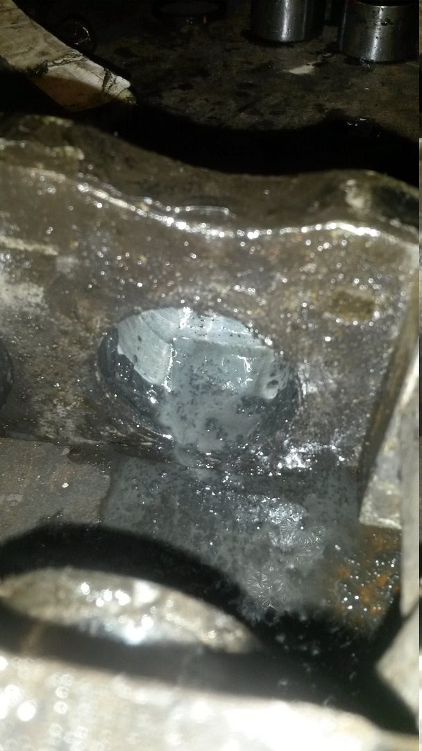

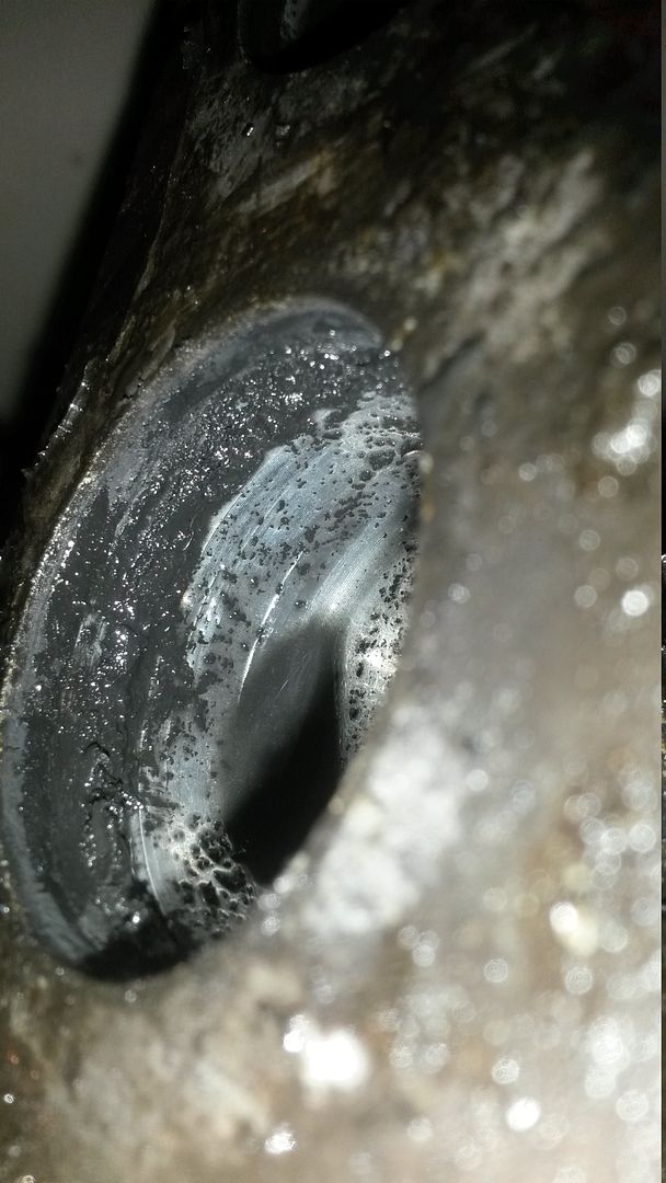

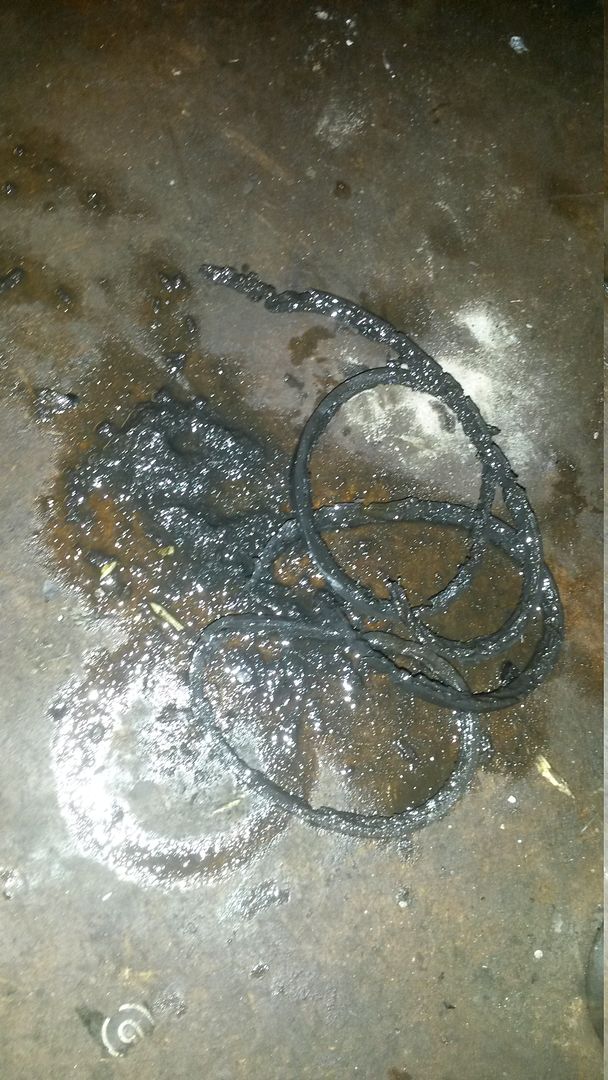

Update on the caliper refurbishment, this is the message I received from the company doing the overhall:
“Hi Ranjan, I have stripped the calipers down and the seals were in a real bad state, pics attached. I don't know how they have worn so bad in all my years not seen anything like this the seals had turned to jelly”
Ranjan.

Post by warpc0il » Wed May 08, 2019 11:03 pm
The only time I've seen seals melt like that was after someone had attempted to lubricate the pistons with something totally inappropriate.
The seals are designed to be resistant to brake fluid but that doesn't mean that they can cope with all solvents, either directly or within a grease or lubricant spray.

My thoughts exactly; bet some form of petroleum based or mineral oil based product was used for lubrication.
Ranjan.

They will be better than new when you get them back as SS liners will probably be inserted.

That's an eye opener! I've refurbished a few calipers over the last couple of years, but never seen seals as bad as those. You'll be glad to be shot of them!
