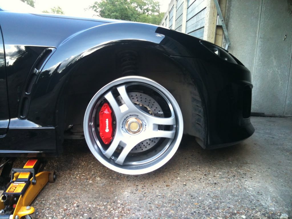

Some new rims for a bit of track fun they need a refurb maybe gloss black or matte but I need to start saving for some rubber first.
RX8Head
Posts: 8055
Joined: Tue Mar 14, 2006 8:03 pm
Location: Abbots Langley, Herts
Has thanked: 6 times
Been thanked: 18 times
Re: Shiftys Black Beast GRRRRRRR (HEAVY MODs)
Post by RX8Head » Tue May 31, 2011 6:43 pm
Rims look as if they should look nice although it's hard to see how they'll look without any rubber on them plus every time you park you you'll have to try and park so you can show off the brembos full :P .

Lol yeah did think they had the perfect curvature for the Brem,s il have to get out and jack the car each time and rotate the wheels,
I agree its hard to tell at the moment but I definitely think they need to be black silver just looks cheap on after market rims i was gonna have ago at doing them myself but I dont think il bother.

Loving the wheels.
Personally I wouldn't change the colour, they offset the black really well.

Na seen silver on a black rex and its a little boring also they have been refurbed but there pretty rough just need to get some black centres which are like gold dust apparently.

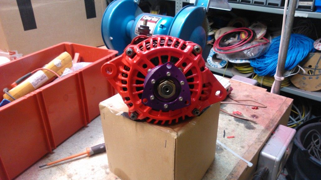

Well the sun has finally started to shine well a bit anyway so I thought it was time to pull my finger out and get some stuff done on the car so here it is the first part of my Pre-Japfest mods was gonna do it all in one hit but ive been taking lots of pics of each job so will be posting as I go so heres part one.

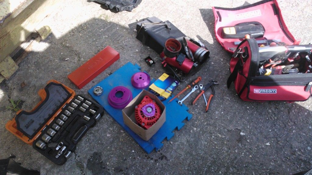

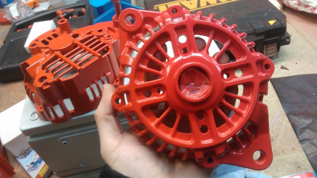

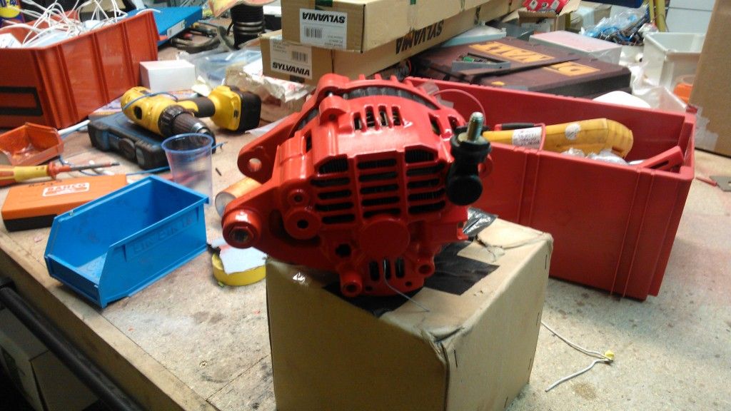

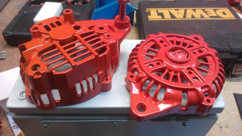

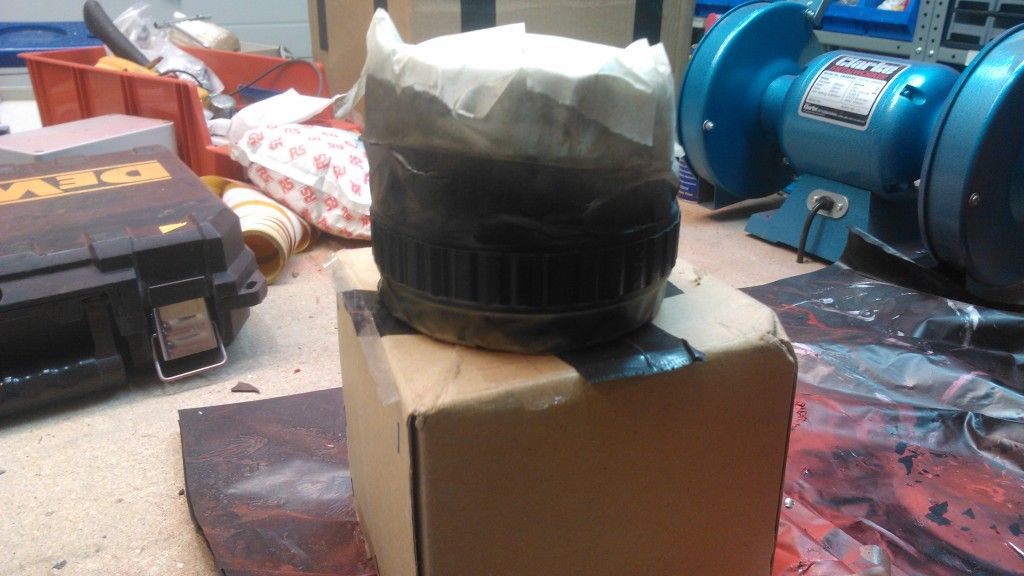

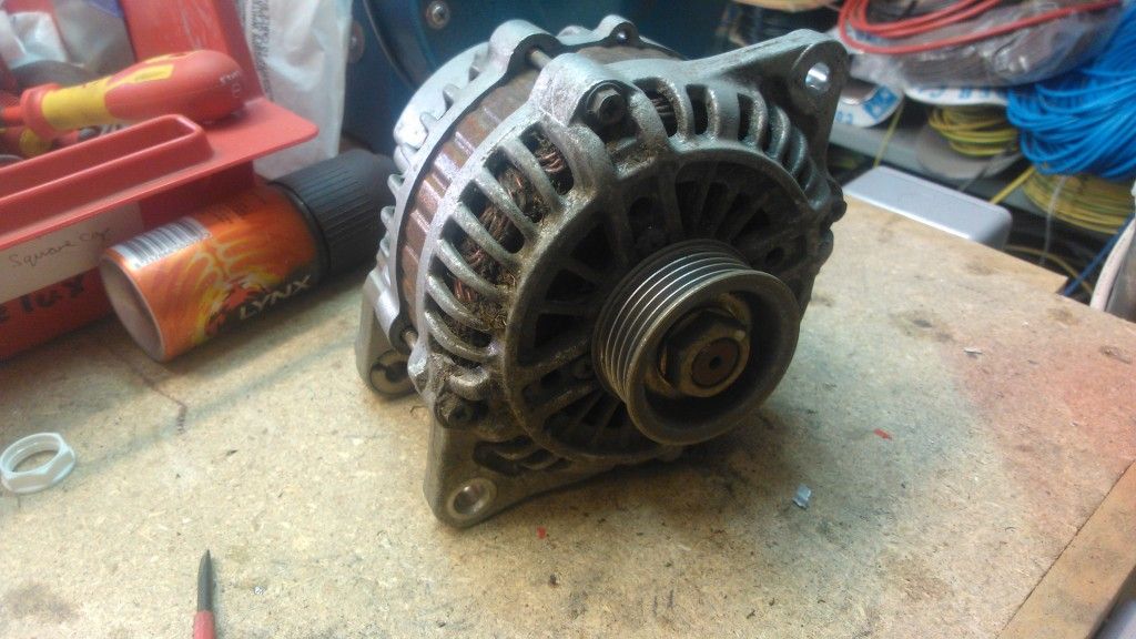

Ok so I thought its time for a bit of engine bay tarting and as I have an AEM fitted this leaves the alternator exposed so I bought a spare and set about making it a bit more visually appealing.

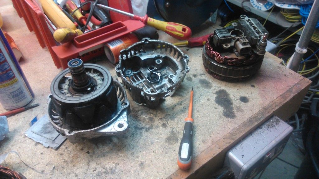

Stripped the sucker down

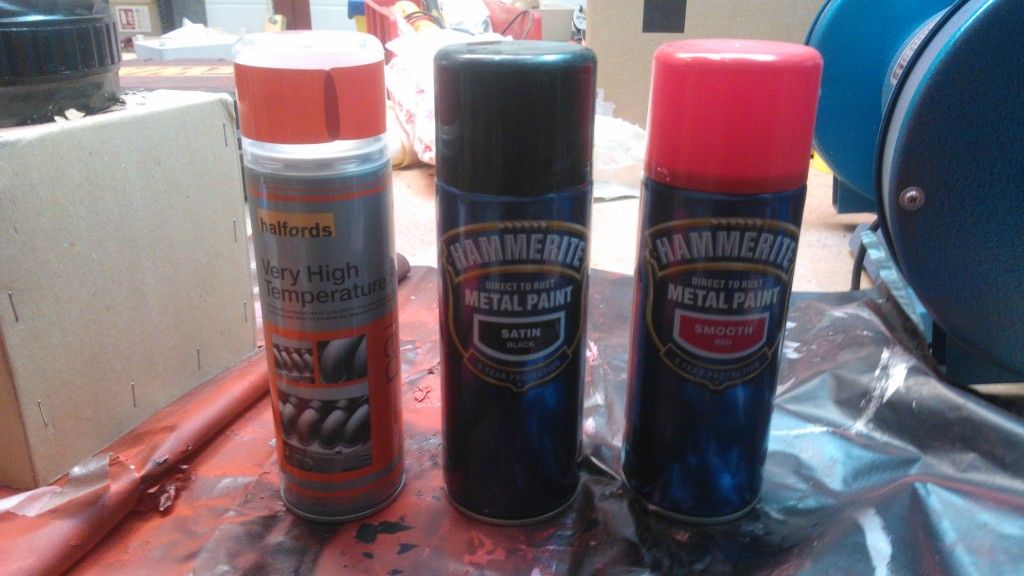

Got some spray I used halfords high temp paint as a primer as hammerite doesnt bond to ally but I used red hammerite as the main coat due to the halfords stuff being matte and almost orange in colour I also gave the windings a quick coat with black hammerite.

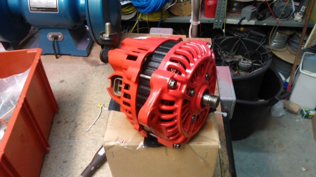

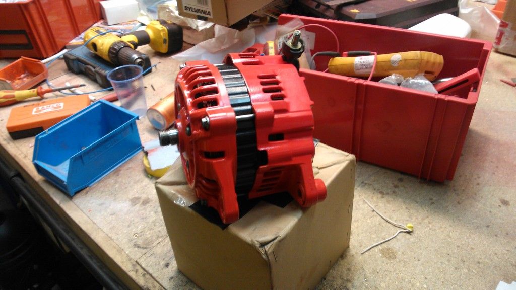

All assembled turned out not to bad but id suggest to anyone else get it powdercoated as spray chips really easily.

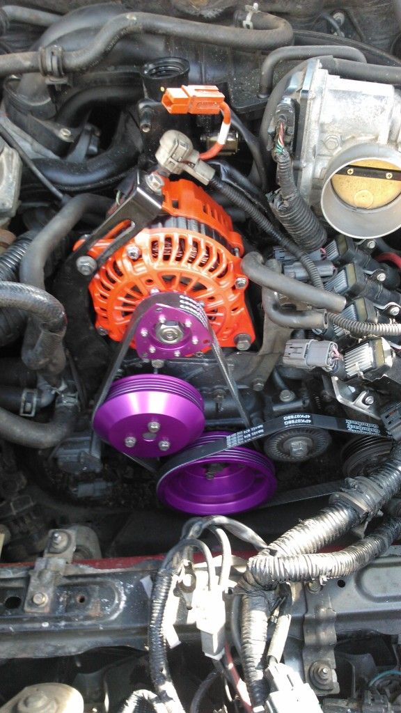

And a shot with my super now pully fitted the purple doesnt really go but cant have it all I guess.

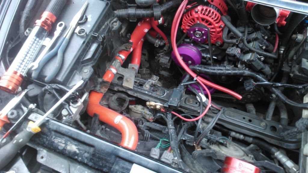

Time to install

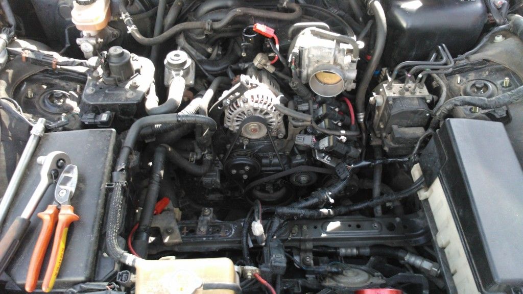

AEM and batt removed.
All bits fitted
Did a full Ecu reset and I was away didnt feal any more power but she definitely revved up alot easier but I wasnt going for power gains so im not bothered.

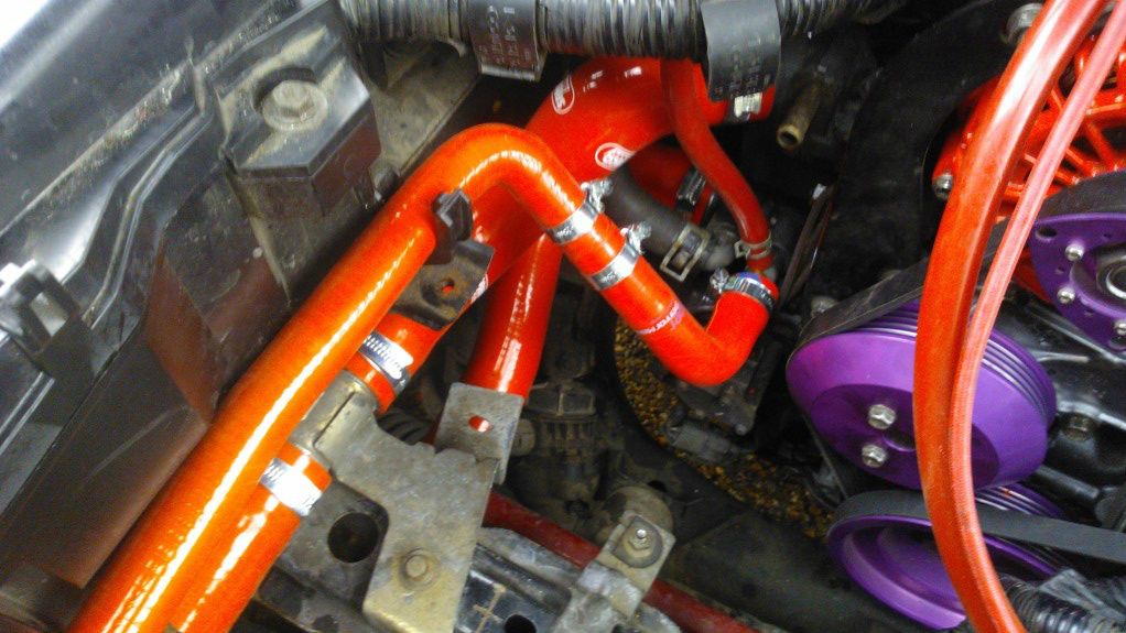

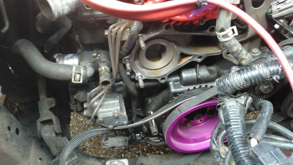

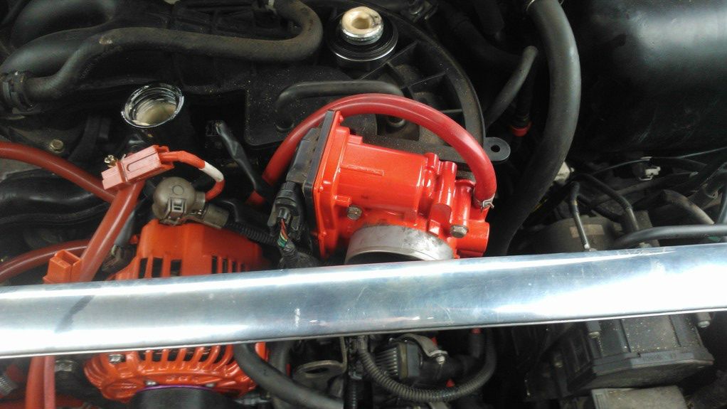

Part 2 install Samco hoses , Re-medy water pump , Re-medy thermostat and painted throtle body.
Heres a pic of the painted throttle body I used the same method for painting this as the alternator I also replaced the hose going to it although I may replace that if I can get a proper formed one but this wasnt in the samco kit also spot my oil cat lots of gunk bloody moisture :evil: .

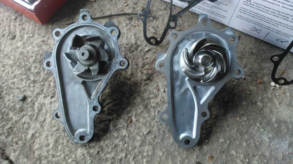

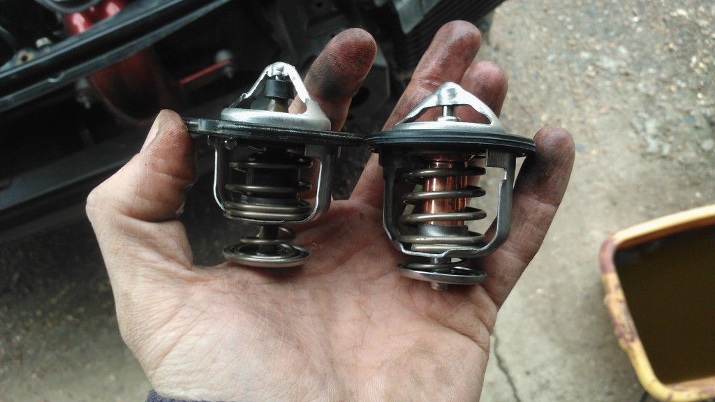

Got the thermostat out bit of a bitch but managed it see here the OEM one on the left and the Re-medy one on the right slightly different in size .
Old pump stripped out really easy makes a change.
Here is the 2 side by side oem left Re-medy right see the difference in the impeller.
Stripped the old hoses out what a bitch that was the rubber seemed tu fuse to the metal but got there then it was install time had no problems with size other then one hose.
This is the hose with the issue it was to short and pointed the wrong way but I had pre-empted it and bought a 90 degree elbow from viper performance which was identical in coulour size and probably slightly better on quality shame they dont do a full kit anyway I trimmed the 90 down and cut a bit of the samco hose then used a metal joiner and some clips and hey presto a perfect fit.
Well thats it so far but the weekend is still yound and there are a ton of other projects to do in the engine bay and else where so watch out for stage 2.

It took one mullerd alternator to figure it out but its actually no to hard but it requires a little bravery as its all pressed together o will say at no point should a hammer be used as that's what mullered attempt number 1 I was lucky we have a hydrolic press at work
fakedollar
Posts: 2165
Joined: Mon Aug 01, 2011 1:52 am
Post by fakedollar » Thu Apr 12, 2012 9:34 pm
So you need a press to put it back together??
